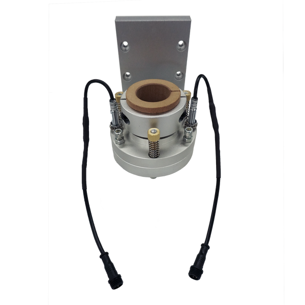

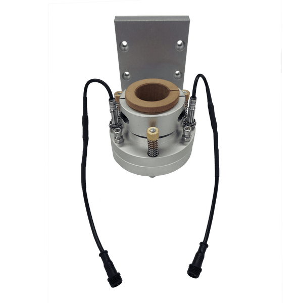

I got this 2 sensor round torch mount. I didn't get their sensors so I could get better sensors.
Hookup schematic S15123.r2 shows one sensor used for the TorchFloatSwitch and the other one for the TorchBreakawayOK switch. I read that the TorchFloatSwitch will be used for TorchBreakawayOK if triggered outside of a touchoff operation. Therefore wouldn't it be better to connect both sensors as TorchFloatSwitchs?
What is the best sensor to use for detecting aluminum?

Re: DIY Table Upgrades
Please help. Touch off and torch breakaway not working.
I got 2 Micro Detectors AES-CN-1F proximity sensors for my new round mount. They are NPN NC switches. https://www.automationdirect.com/adc/sh ... /aes-cn-1f
They are wired according to schematic S15123 ( https://www.centroidcnc.com/dealersuppo ... 123.r2.pdf). One sensor is configured as a TorchFloatSwitch connected to input 4. The other sensor is configured as a TorchBreakawayOK connected to input 7 with the input inverted. The TorchFloatSwitch is configured in the wizard as the only touch off method. The input state when triggered is closed.
The torch touch off button will move the torch down and touch the surface and start to reverse to the safe height. However, it fails prior to reaching the retract height. I tried other configurations but nothing worked correctly.
A report file is attached.
Just wire both proximity switches as float switches and remove the breakaway.
If the Float switch trips outside of a touch off cycle it will be treated as a breakaway.
So you still will have the breakaway switch functionality.
Thanks Joey. I wired both sensors in parallel and connected them to input 4 defined as TorchFloatSwitch. It appears that Touchoff and Breakaway are both working.
With the breakaway configuration, the machine is less tolerant to warped material. Now I see the need for THC even more than before. My X&Y axes have a OTR of 1.59155. I am able to reliably get 500 IPM movement. The Z axis however has a OTR of 6.042479 and only 100 IMP reliable movement. Would the THC work okay with this configuration?
Correct me if I'm wrong here but they should be wired in series so if either one trips it triggers the circuit. Not both. If you have them wired in parallel it'll take BOTH being tripped to trigger a "breakaway" outside of the touch off command. So I'd be careful right now as it'll take a lot to trip a breakaway while cutting. You don't want to break a torch.
Cutting thin material almost requires THC as it warps all by itself at any given time. It's really cool to see the torch jump and follow the warps when cutting.
That's what I thought too. But schematic S15124 shows 2 sensors on a 3 sensor round mount being wired in parallel configured as Breakaway. I also tested it and either sensor tripped alone will signal a Breakaway. I had to configure "The input state when triggered is closed" in the wizard.
