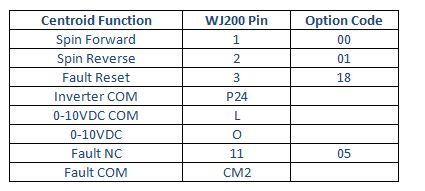

Maybe I am interpretting this wrong?
I was reading CM2 on wj200 to inp9-12 on allinonedc and Fault input on allinonedc to 11 on wj200.
Guess I am dense and want a line drawing like the other inverters had LOL.

That said, I don't understand why you are trying to use CM2 and the open-collector outputs at all.
Doesn't your inverter report a fault using its alarm relay output (terminals AL0, AL1 and AL2)?
If so, you should connect +24VDC to the INP9-12 common terminal on the PLC; connect 0VDC to the AL0 terminal on the inverter; and connect AL2 to INP10. Then change Parameter 178 from 3 to 1, since you will have a normally-closed inverter fault signal.[/quote]
You're correct that his inverter SHOULD output the alarm as a relay closure. But let's say (just for grins) that it didn't.
Then a pullup resistor to +24 with the other end of the resistor going to the inverter fault input, and with -24 going to common AND the inverter "fault" common, THEN an OC output on the inverter would apply the signal he wants. It's probably not necessary (as you said, and maybe not even possible on his inverter), but it would work.
There are fifty ways to skin this cat.
