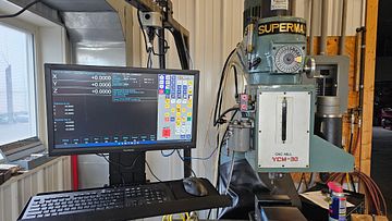

Thanks for the reply and the lead on different motor options!! More options are always a good thing!
I am still leaning towards upgrading to Clearpath motors given their tunable design, but I am a tinkerer that is also a glutton for punishment! I have everything designed for the motor adapters and the aluminum stock for them on hand. I also have found a shaft adapter that will work in conjunction with my motor adapter design to allow for the use of Clearpath motors.
I'll still take a look at the motors you identified and put together a comparison (cost, design elements, etc.) to see if there are other things that I should be considering that might pull me away from Clearpath.
The upgrade work I want to do to my mill keeps getting pushed back as my regular business (Agricultural Drainage) must take precidence. Given that the machine is working now, I am kind of at the point where I am using it when needed, but not pushing it so much so that I cause issues. Winter & Summer are my downtime for my main business so that is when this machine gets used and/or could be upgraded. Its slow progress, but having a plan is better than winging it.

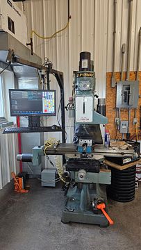

Here is the mill as it sits today:
I have the acorn controller and (3) DM860T drives in the original CNC4 control box (I'll take pictures the next time I need to get inside the box). The computer is a BeeLink EQ12 mini PC (Intel 12th gen N100, 16GB DDR5 Ram, & 500GB SSD) Vesa mounted to the back of a Viewsonic TD2211 22" touchscreen monitor with keyboard tray. I also now have the Centroid wireless MPG pendant.
