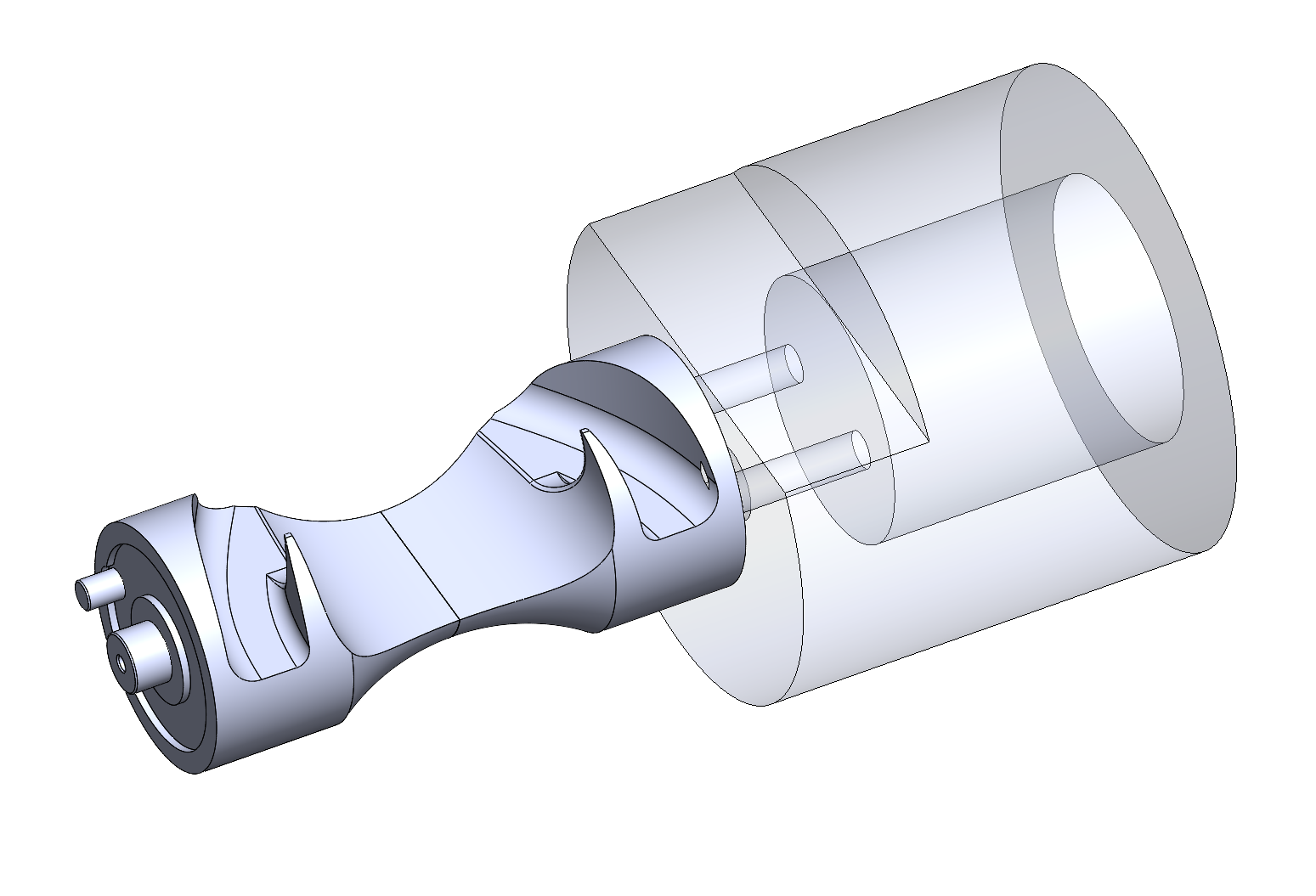

I was able to enable the 4th axis (I am running it rotating around the X axis on a 3-axis mill pointing in the X- direction (right hand side of the mill table) in the post. I was also able follow instructions in the Autodesk post manual (section 7.6) to steal code from one of their Haas with trunnion posts and insert it into the Centroid post to get the inverse time feed rates working for interpolated 4-axis moves.
So far I have used it to machine some air with these basic 4-axis tool paths that I have been learning:
https://forums.autodesk.com/t5/hsm-supp ... p/10115274
and the post processor seems to work, despite some issues I have noticed.
You may be way ahead of me though! I think I will try yours out, I am ready to set up and start making some test parts now so I can give you feed back.
My system is: Solidworks w/ HSMworks CAM, Centroid Oak, and proper 32"x16"x20" mill with 10" rotary with brake, all AC servo, tool changer, and spindle encoder for rigid tapping.

I have machined some air with tool paths produced using Swissi's post processor and it seems to basically work.
It fixes at least one shortcoming of mine. i wont go into detail here as I have not verified on parts yet.
But will post some real results when I get them! hopefully this week.
making these:
making these:
