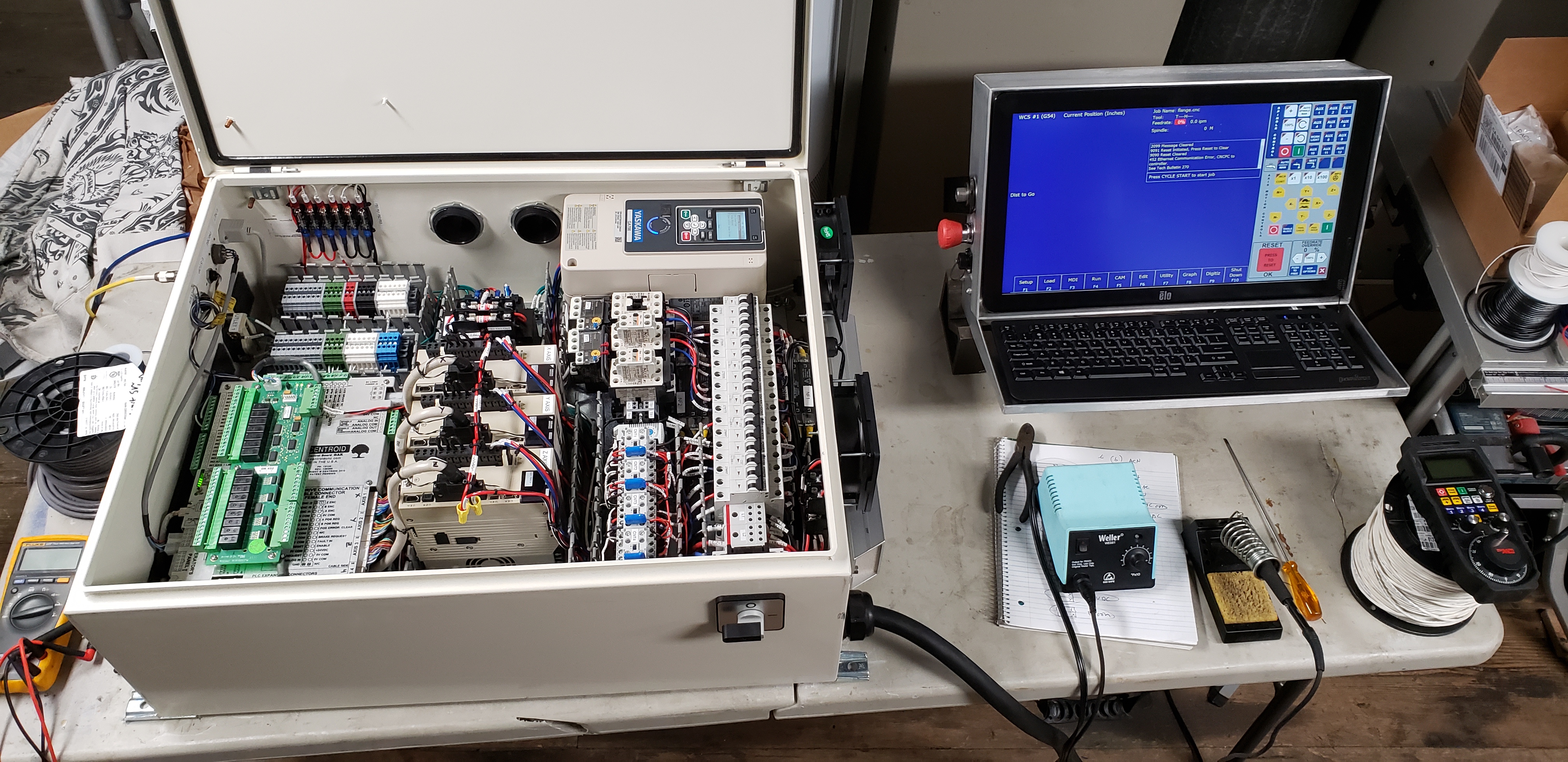

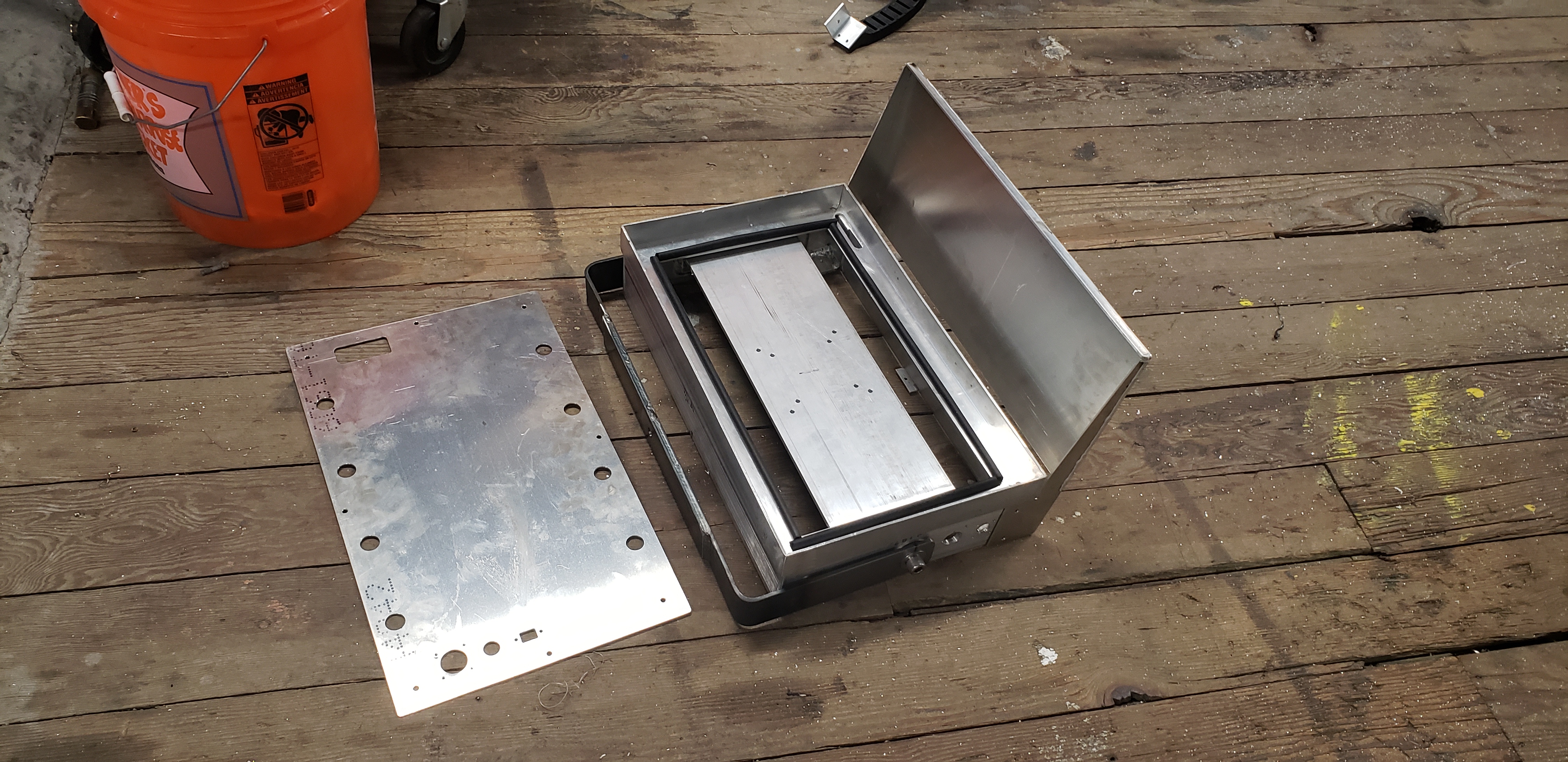

Re: Oak Control, Yaskawa Servos, on Brand New Rigid Head Bed Mill with ATC

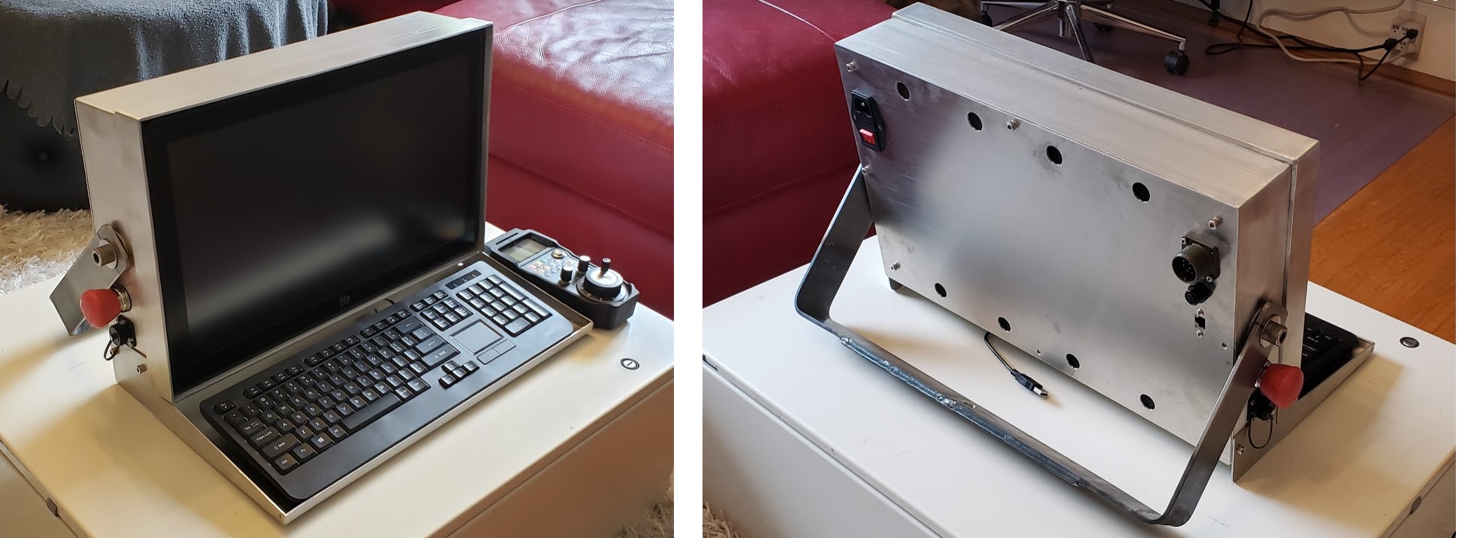

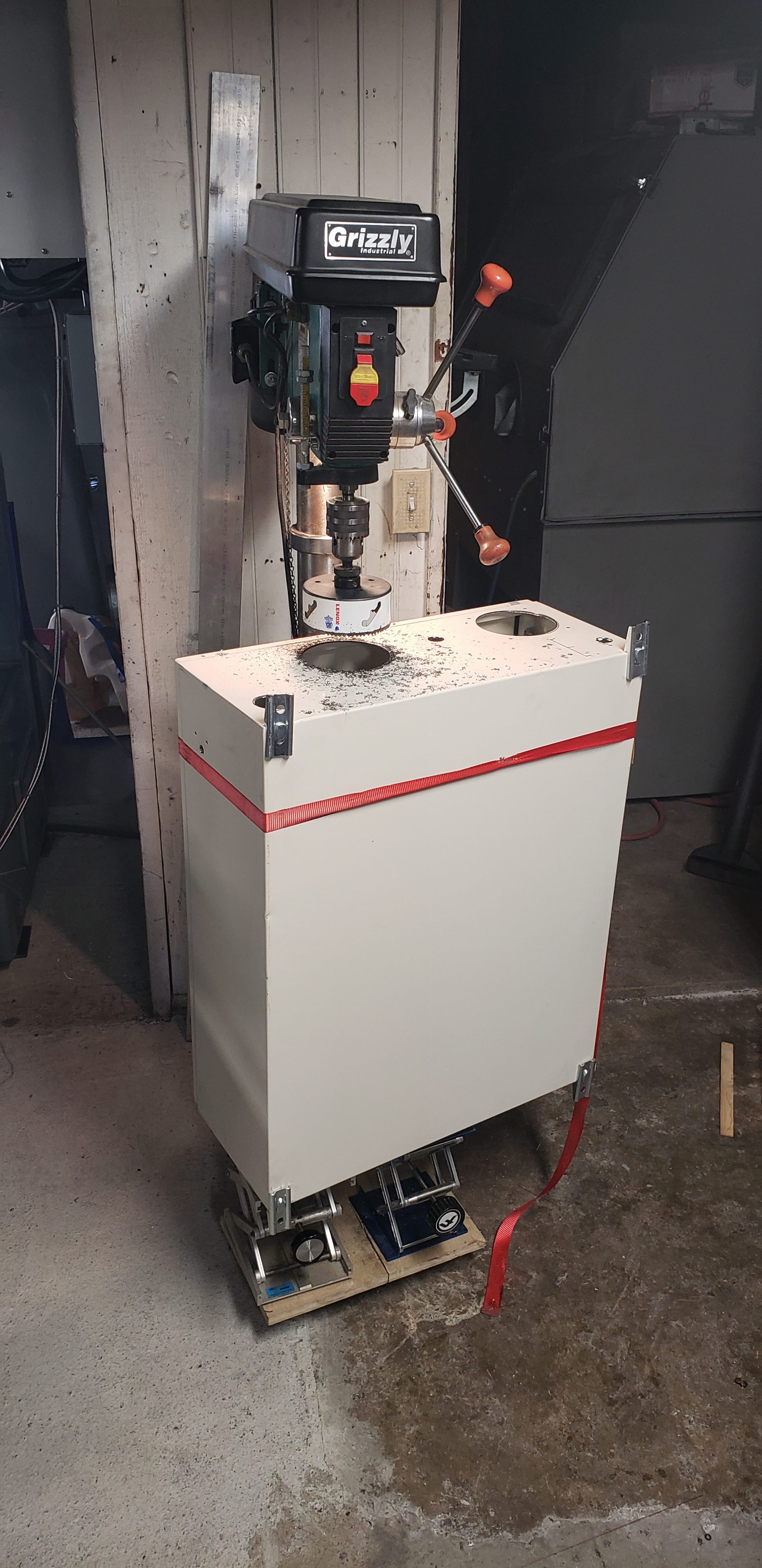

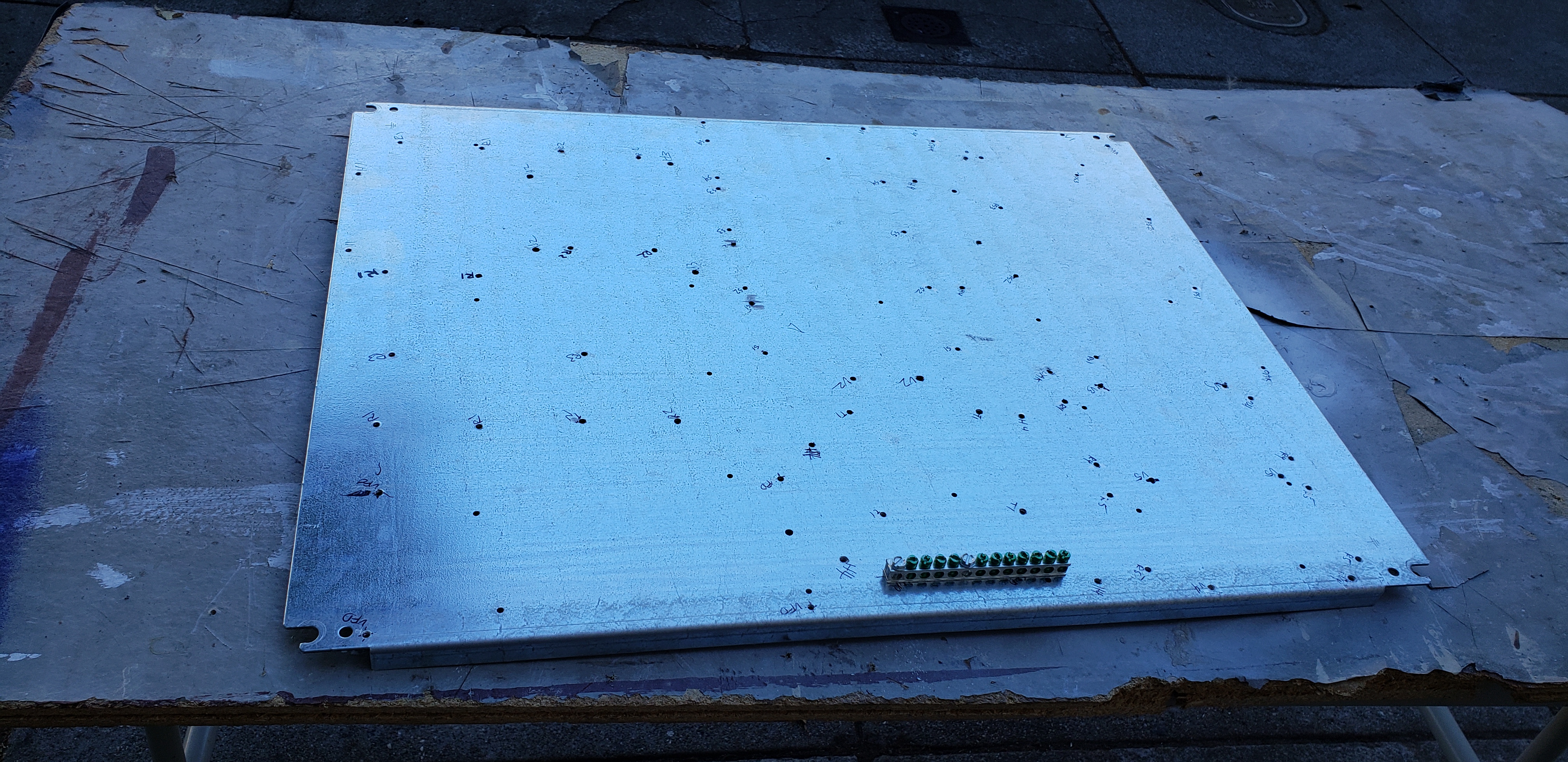

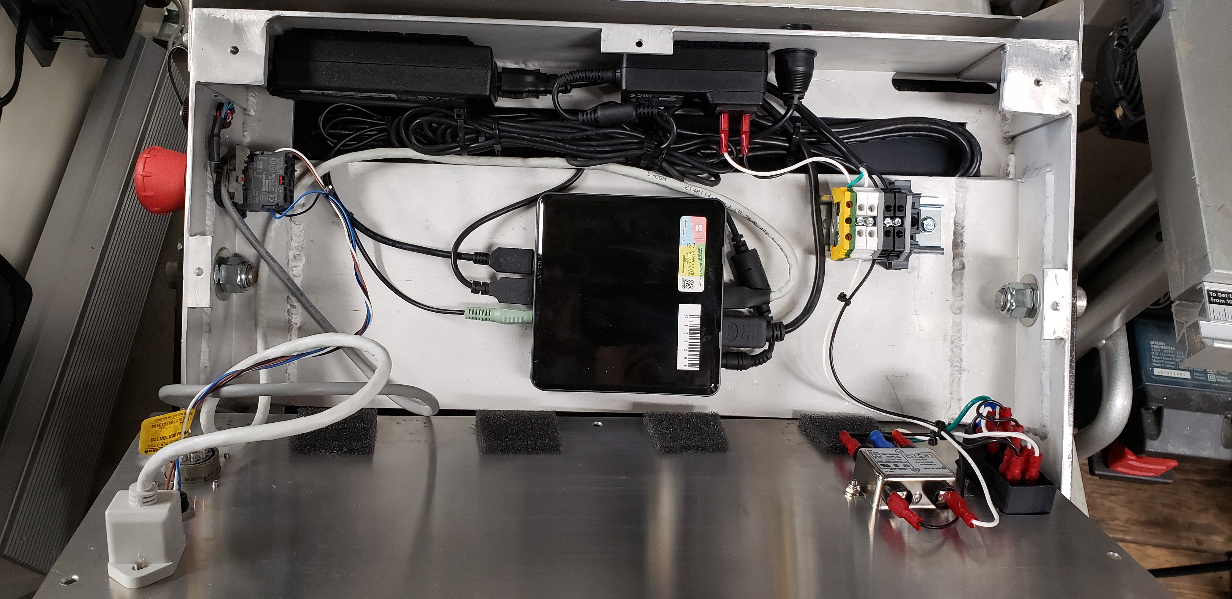

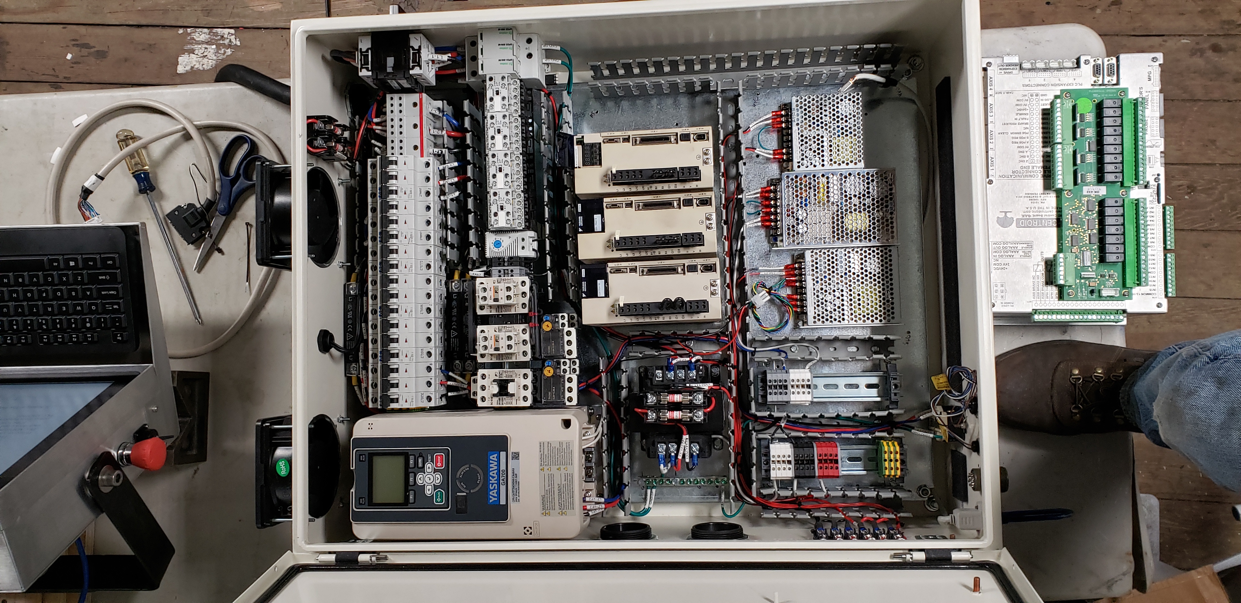

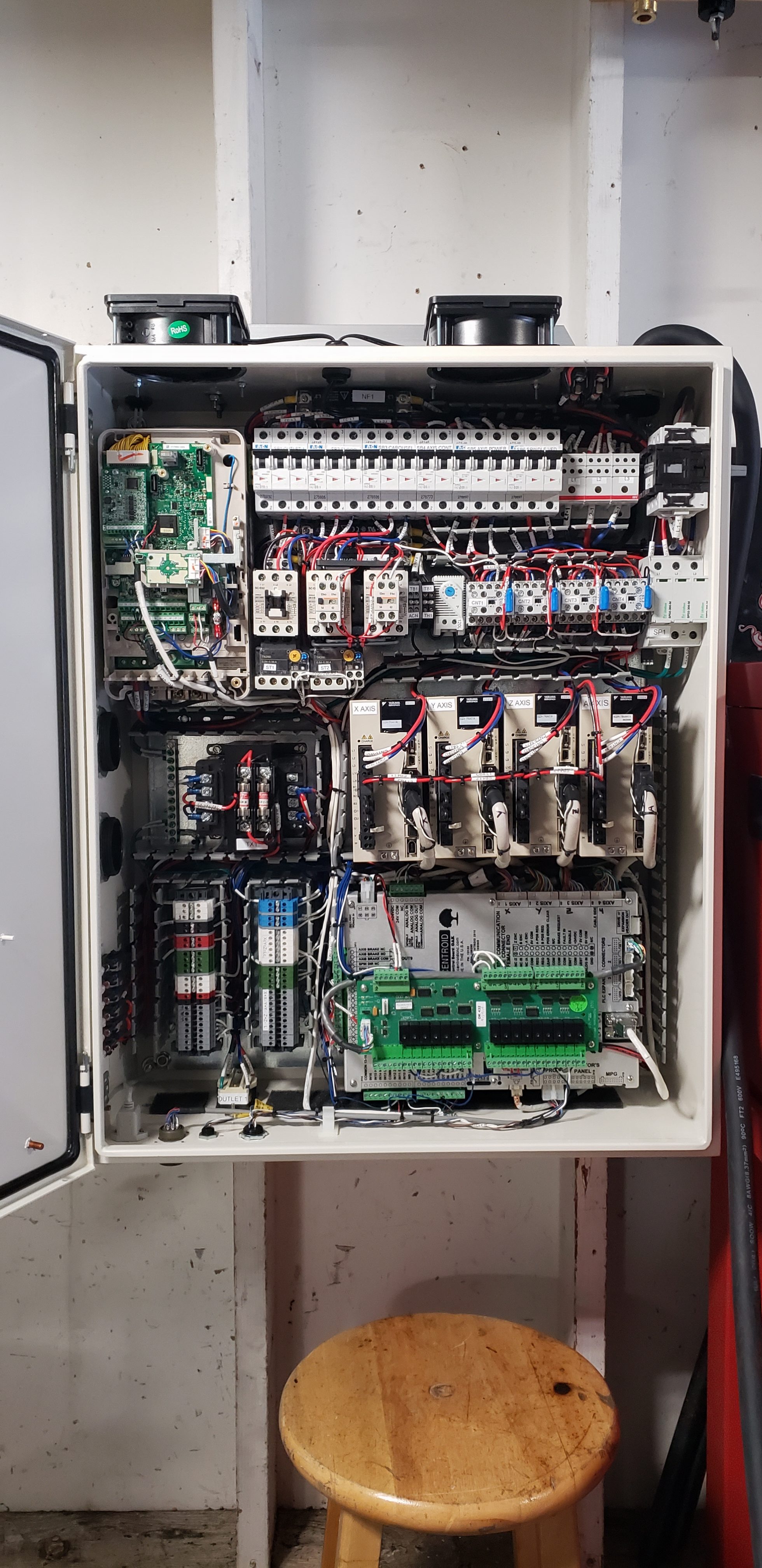

Just wanted to post some photos of the progress i have made with this build.
My Computer control console:
My electronics cabinet:
Hmm, pictures not showing up....
can you see them now?
I am using google photos, and cant figure out the best way to get the link. some methods work and some don't, some work but not for all photos it seems...
Some showed some have not. Better if you just upload them here using the attachments tab under the Full Editor option
